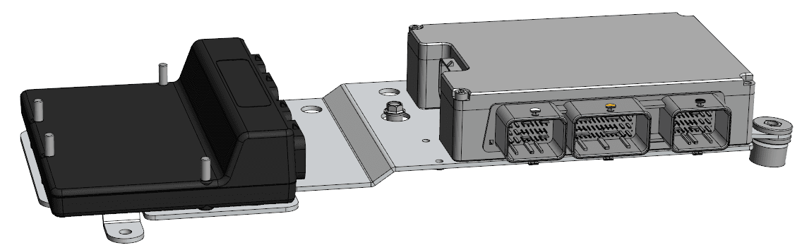

INSTALLATION
The following procedure details installation of this kit into a Mercury Racing QC4V.
Step 1:
Remove the engine cowl. Disconnect the 3 engine harness connectors from the OE ECU.
Step 2:
Using a ratchet, extension and 10 mm socket, remove the 3 flange bolts that secure the OE ECU to the OE mounting plate, and the 2 flange bolts that secure the rear of the mounting plate to the manifold.
Step 3:
  1. Remove the OE ECU and detach the 3 rubber grommets and spacers from the ECU.
  2. Fit the grommets and spacers to the MoTeC mounting plate in matching positions.
Step 4:
Assemble the MoTeC kit components onto the mounting plate:
  1. Connect the Adaptor Stub Looms to the M150. When connecting Adaptor Stub Loom D, the Ethernet comms cable end must be connected to the M150 (Pin D23 to D26).
  2. Attach the M150 ECU to the Mounting Plate by sliding carefully on to the 4 captive studs on the plate. Secure the M150 by means of 4 x M5 Nylock nuts and 4 x M5 washers.
  3. Connect the Breakout Loom plug to the Adaptor Box, ensuring that the cable assembly exits towards the port side of the mounting plate when installed on the engine.
  4. Slide the Adaptor Box into position towards the M150, ensuring that the Breakout Loom cable is positioned under the Stub Looms.
  5. Connect the Adaptor Stub Looms to the Adaptor Box.
  6. Attach the Adaptor Box to the mounting plate by fitting supplied M4 x 10 screws and M4 flat washers to the underside of the plate and screwing into the adaptor box.
Step 5:
Install the assembled adaptor kit onto the Mercury Racing QC4V engine. Do not fit the centre flange bolt (now masked by looms). Re-fit the 2 end flange bolts through rubber grommets (now located around the Adaptor Box) and fit 2 flange bolts to the folded plate bracket below the M150 ECU.
Step 6 (optional):

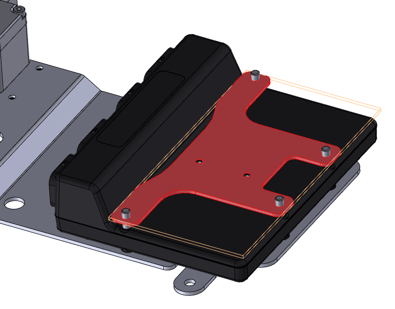

Complete this step if dual lambda measurement (using supplied LTCD and NTK sensors) is required.
Mercury Racing QC4V engines have water cooled exhaust manifolds which do not have OE exhaust Lambda probes. Comprehensive engine tuning requires Lambda measurement and this Plug-In Kit is supplied with two NTK probes and a MoTeC LTCD device.
  1. Attach the LTCD to the LTCD Mounting Plate by fitting supplied M3 x 30 screws through the top of the LTCD and screwing into captive threads in plate.
  2. Attach the LTCD Mounting Plate on top of the M150 ECU by sliding carefully onto the 4 captive studs. Secure the LTCD Mounting Plate by means of 4 x M5 Nylock nuts and 4 x M5 washers.
  3. Drill and tap Lambda sensor threads (M18 x 1.5 mm) into the exhaust manifolds in the outlets of the turbocharger exhaust housings.
  4. Install supplied NTK Lambda sensors into exhaust manifold fittings.
  5. Route the DTM4 plug in the Breakout Loom to the installed LTCD Device.
  6. Route the long Lambda sensor plugs from the LTCD to both banks and connect to installed NTK Lambda Sensors.
Step 7:
  1. Route the knock sensor cables from the Breakout Loom to both banks of the engine block and fit the supplied Knock Sensors. Each front engine mount has 4 bolts. Sensor mounting position is on the upper rear bolt, which should be replaced with a stepped bolt onto which the Knock Sensor is mounted.
  2. Connect the 3 Mercury Racing OE harness connectors to the Adaptor Box headers.
