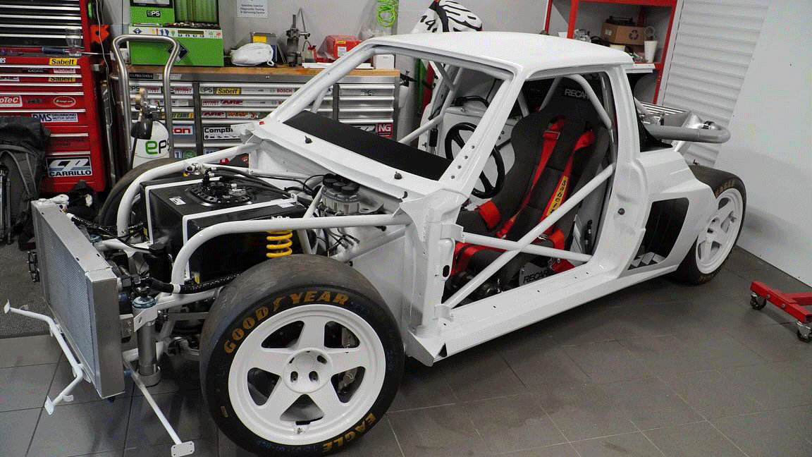

Dave began his project by creating a diecast model as a starting point for his vision. Following this, he then had the photos of the car scanned to create a 3D model of the car which led to the body and chassis design. This was the basis to start building the car. A crucial next step in the process was solving the complexity of the driveline. As the car was unique, no off the shelf solution was available. Dave engineered a custom driveline system utilising bespoke differentials and gearbox. These innovations were essential to bringing the project to life.
Car specs

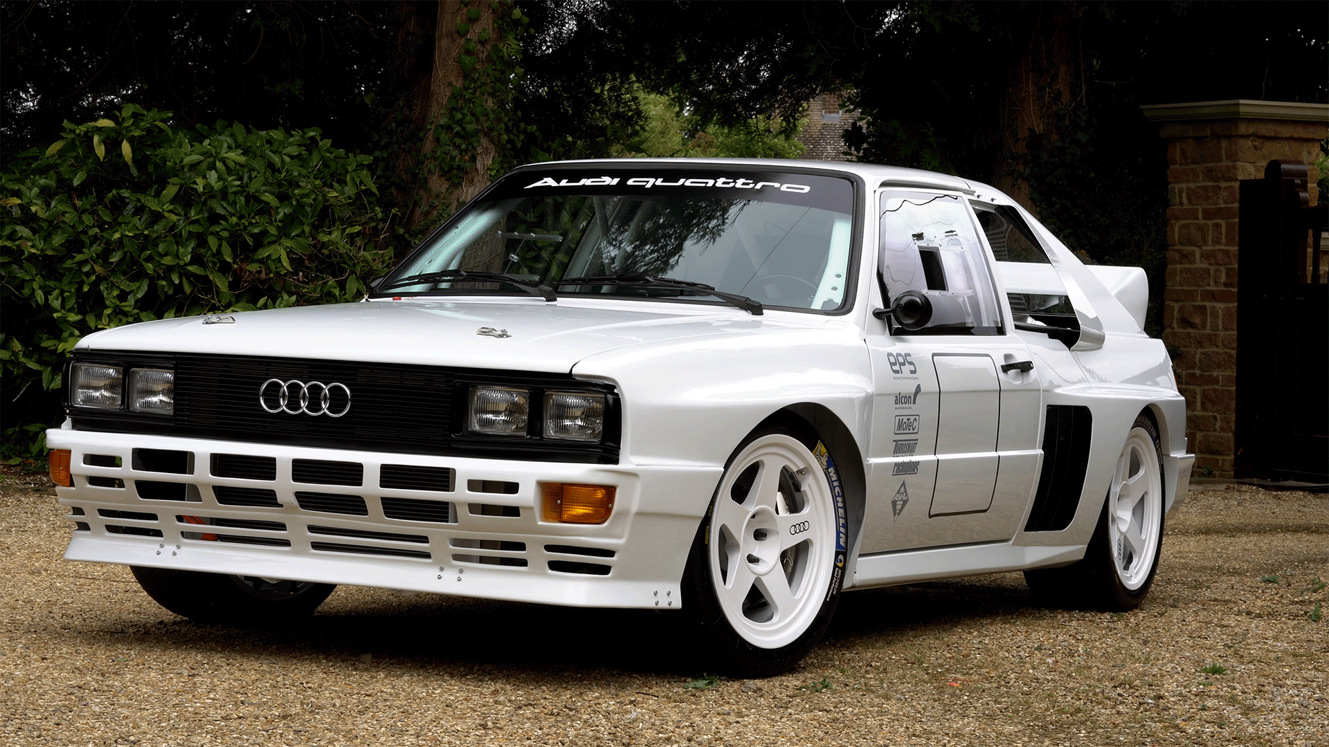

The car is made from a chromoly frame, paired with a custom body that was designed from a 3D model, resulting in a weight of only 1001 kgs. At the heart lies an Audi 5 Cylinder 2.5L engine originally from a TTRS, with an upgraded TurboSmart turbocharger. On the dyno, this setup delivered an impressive 756 horsepower to the flywheel.
Dave opted for the EPS custom 6 speed transmission and differential system to connect the mid-engine all-wheel drive system. The car has KW suspension, along with Alcon brakes paired with a Bosch Motorsport ABS system.

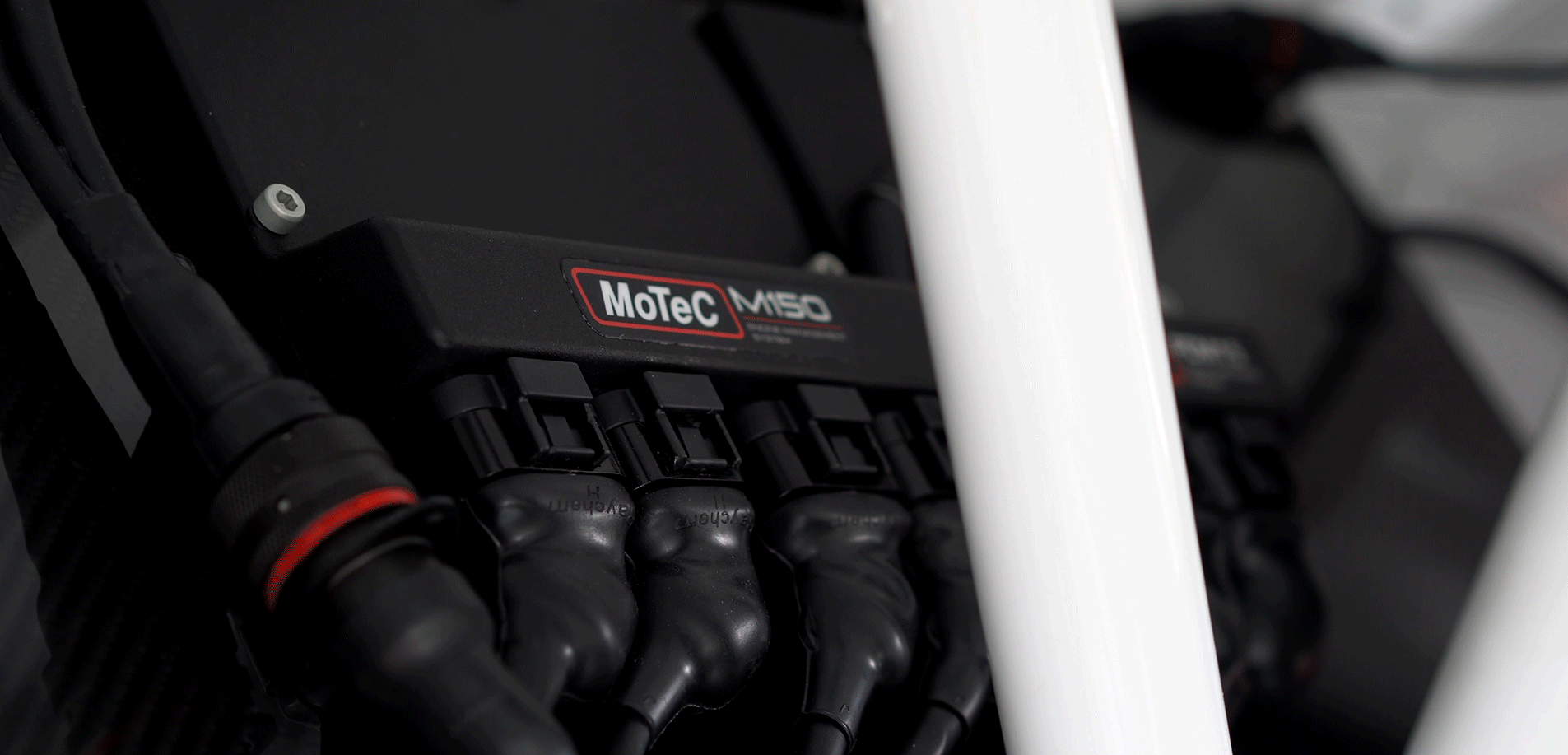

M150 ECU & GPRP Pro firmware
At the core of the MoTeC system is an M150 ECU running our GPRP Pro Package. GPRP Pro is a sophisticated engine control firmware centred around calculating and controlling engine torque via throttle opening and ignition control.
On the Pro platform, Dave’s Audi benefits from advanced traction control, greater configurability for knock control and much more.
